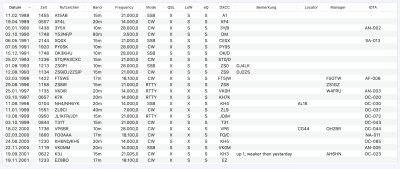

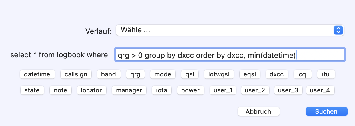

Using a SQLite tool this should work:
select dxcc, callsign, datetime, band, mode from logbook group by dxcc order by dxcc, min(datetime)
In RL you need a dummy for the where clause:
Query
Query
Result
Result

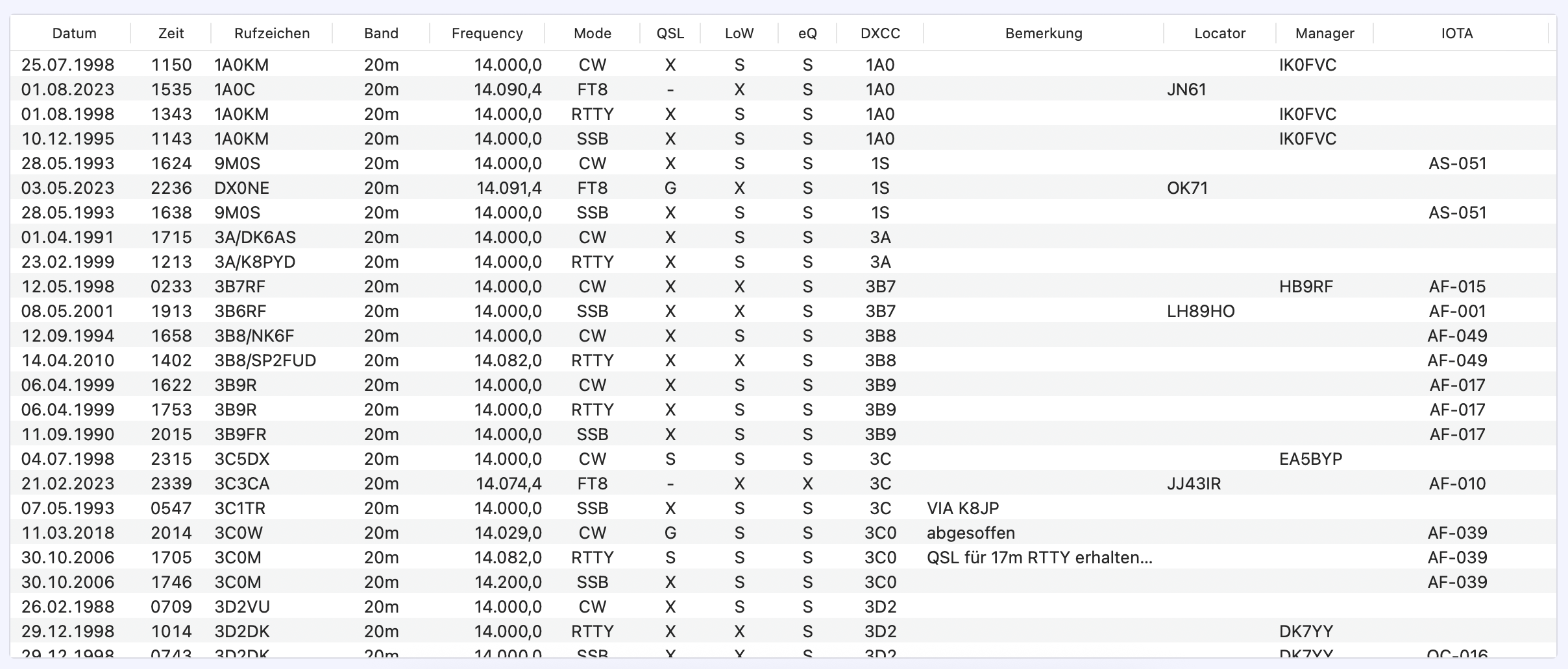

Frequency must be given in kHz! You can use the band information as well. You can combine options to get results by modes:
select * from logbook where band = '20m' group by dxcc,mode order by dxcc, mode, min(datetime)
I'm not very active on 6m, here the result for 20m as example.

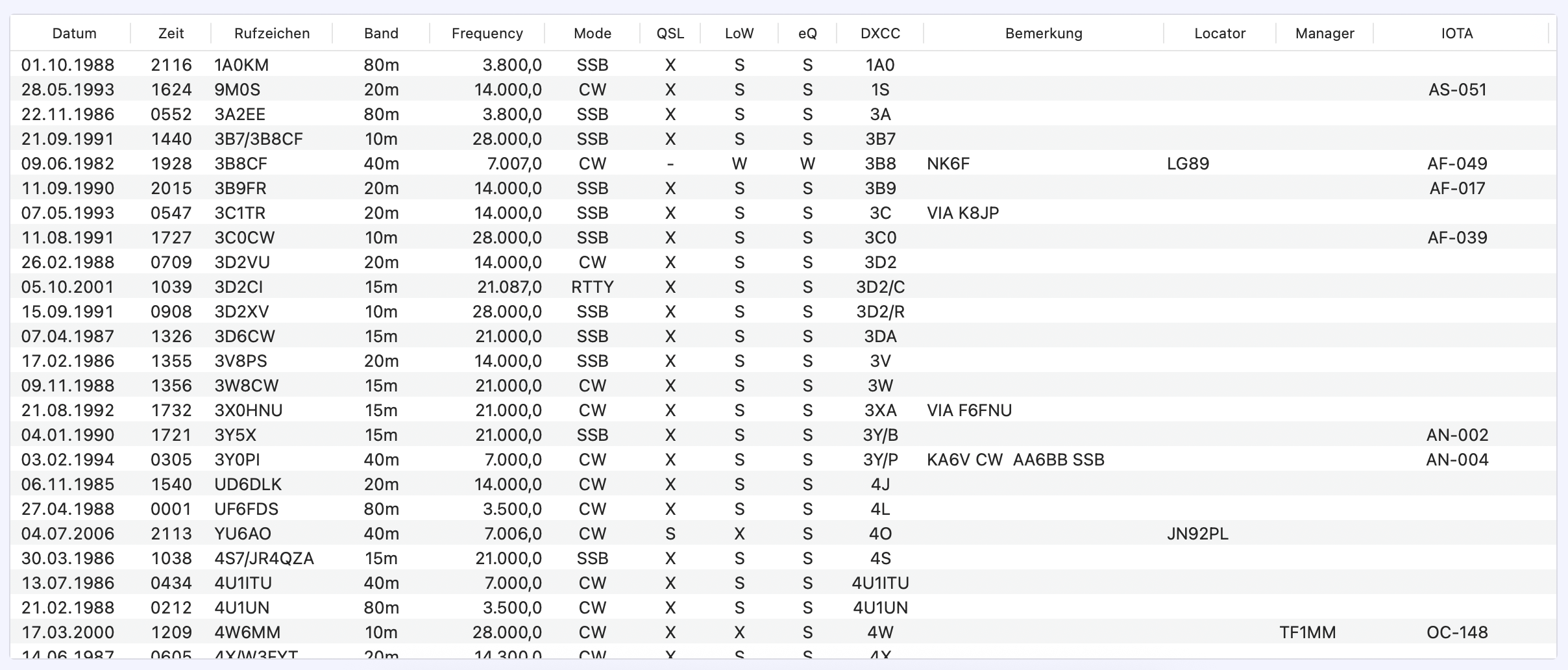

It's also interesting to see, when a country was worked for the last time:
select * from logbook where band <> ''group by dxcc order by dxcc, max(datetime)
25 entities I worked for more than 25 years ago the last time.
