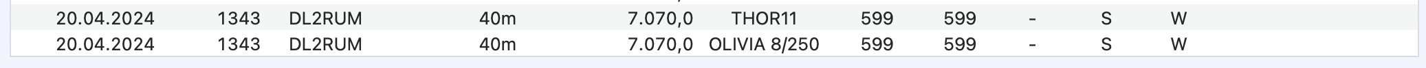

I've logged two QSOs, on in OLIVIA8/250 on in THOR11:

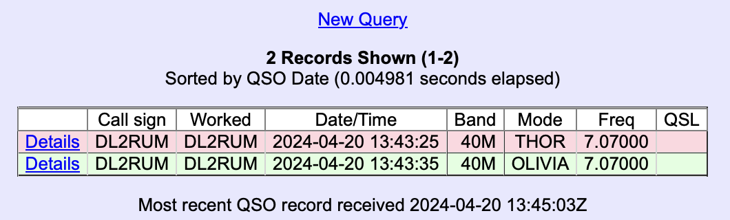

Both uploaded successful:
This is what I send to tqsl now:
<call:6>DL2RUM <qso_date:8>20240420 <time_on:6>134325 <freq:8>7.070000 <band:3>40m <mode:4>THOR <submode:6>THOR11 <eor>
<call:6>DL2RUM <qso_date:8>20240420 <time_on:6>134335 <freq:8>7.070000 <band:3>40m <mode:6>OLIVIA <submode:12>OLIVIA 8/250 <eor>
Do you upload to eQSL or Club Log? Any problems here?
Please run your own tests and report back: https://dl2rum.de/RUMlogNG/RUMlogNG_Test.zip

Tom, this looks perfect. I think adding the Submode to the LoTW uplink will make all the difference. If they were getting the "THOR11" as a Mode previously, they were probably rejecting that as not a valid Mode, but should handle the mode+submode OK. Your tests are very encouraging and I will also give the test build a try.
