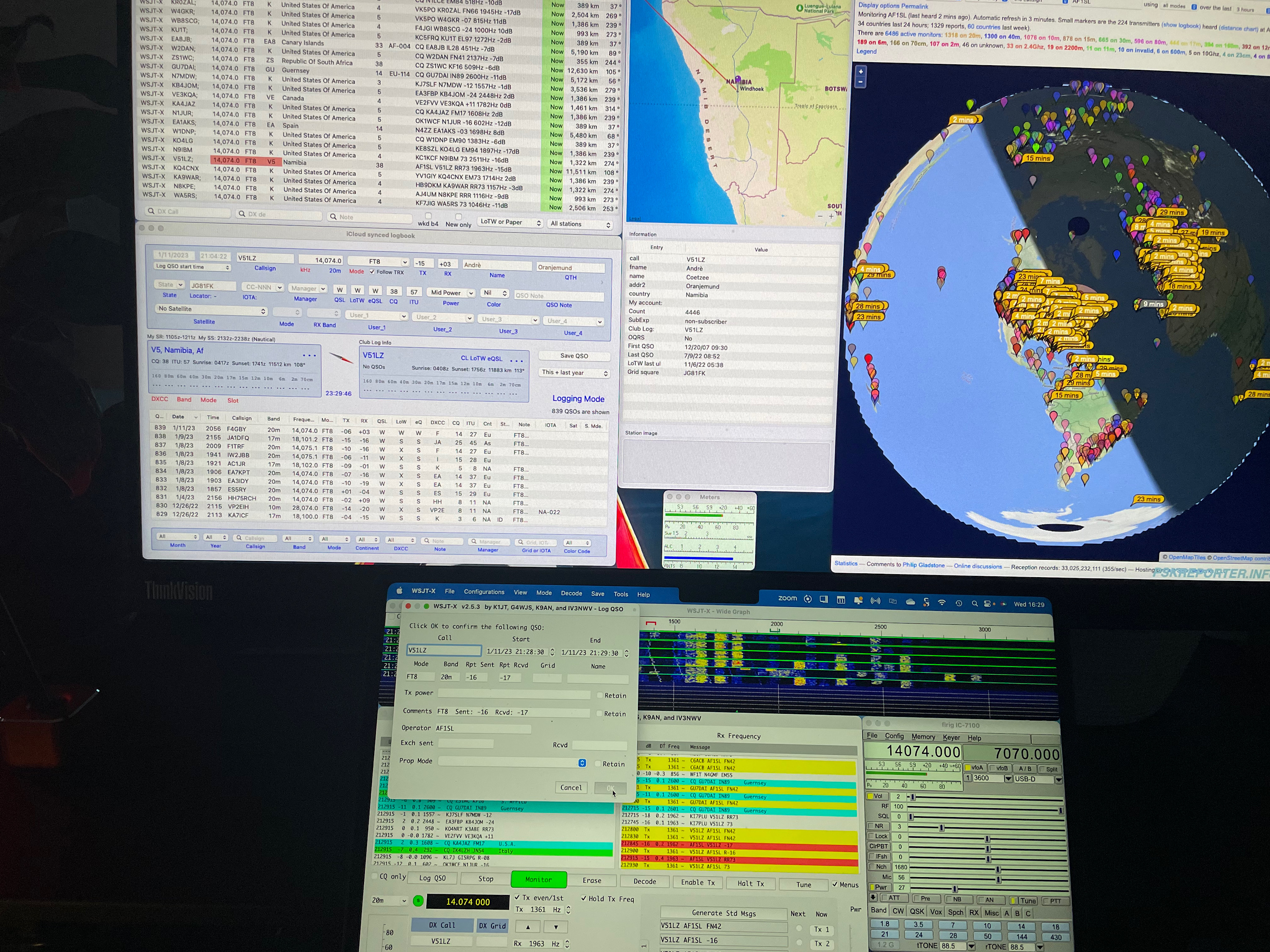

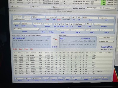

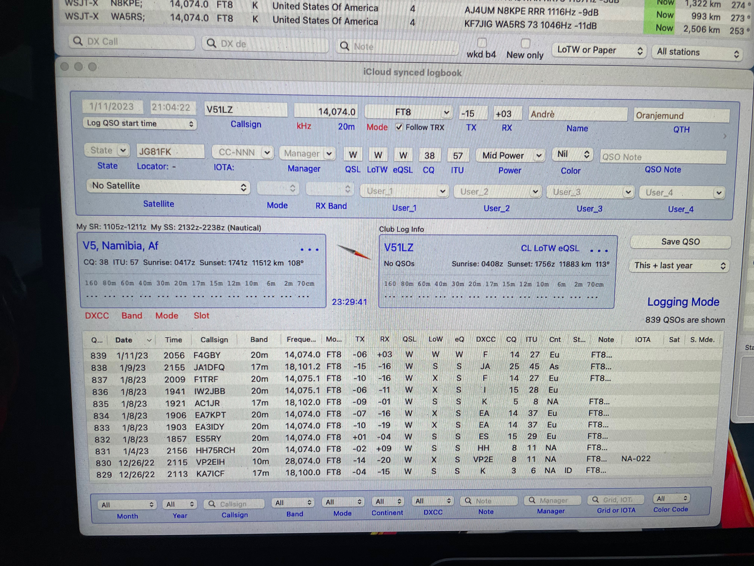

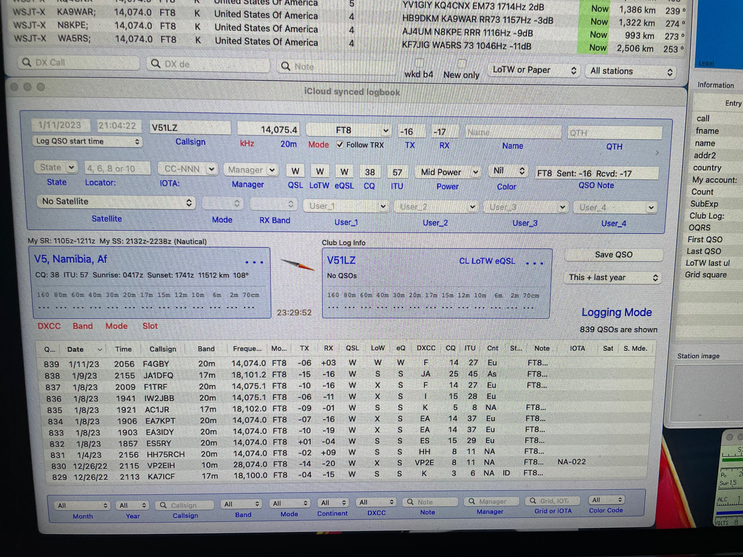

So, further information. Here are some screenshots of my issue:
RUMLog screen prior to saving log entry on WSJT-X;
RUMLog and WSJT-X just prior to saving log entry on WSJT-X;
RUMLog screen after saving to log on WSJT-X (note wrong frequency and empty name and QTH fields). The wrong frequency is why I don't auto save, and now for the last week or so I've had to add the name and QTH entries back in.
Re: RumLog looses the name and QTH info when I click "ok" on WSJT-X logging window
Well, there are few issues since the December updates I'm still working on it.
