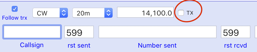

I am wondering what the "TX" checkbox within the contest window is supposed to do.
Whenever I am connected to my KX3 via the BLE dongle it appears and is selected.
Mode is being updated whenever it is changed on the transceiver but neither band or QRG are updated unless the TX checkbox is deselected.
Any hints why this checkbox exists? I am probably missing something.
Robert

This is useful when Split is selected. Normally VFO A frequency (RX) is shown and will be logged. When this box is selected, the VFO B frequency (TX) is shown and logged.
This box should be hidden when not in Split, there may be a miss-behavior for the K3, I have to check.

looks like I have inadvertently been in split mode. It works exactly the way you describe it.
