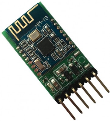

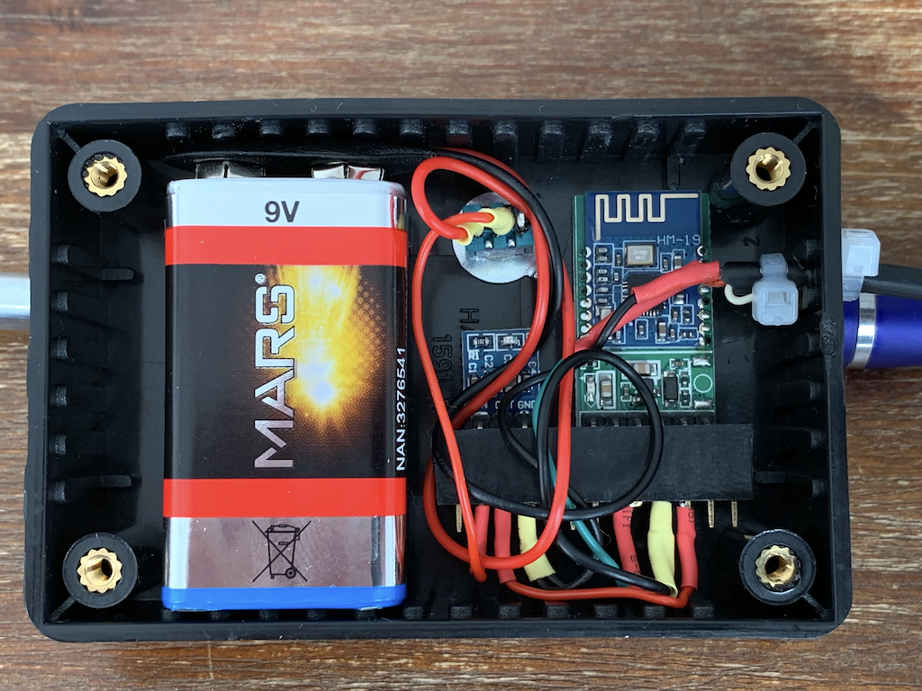

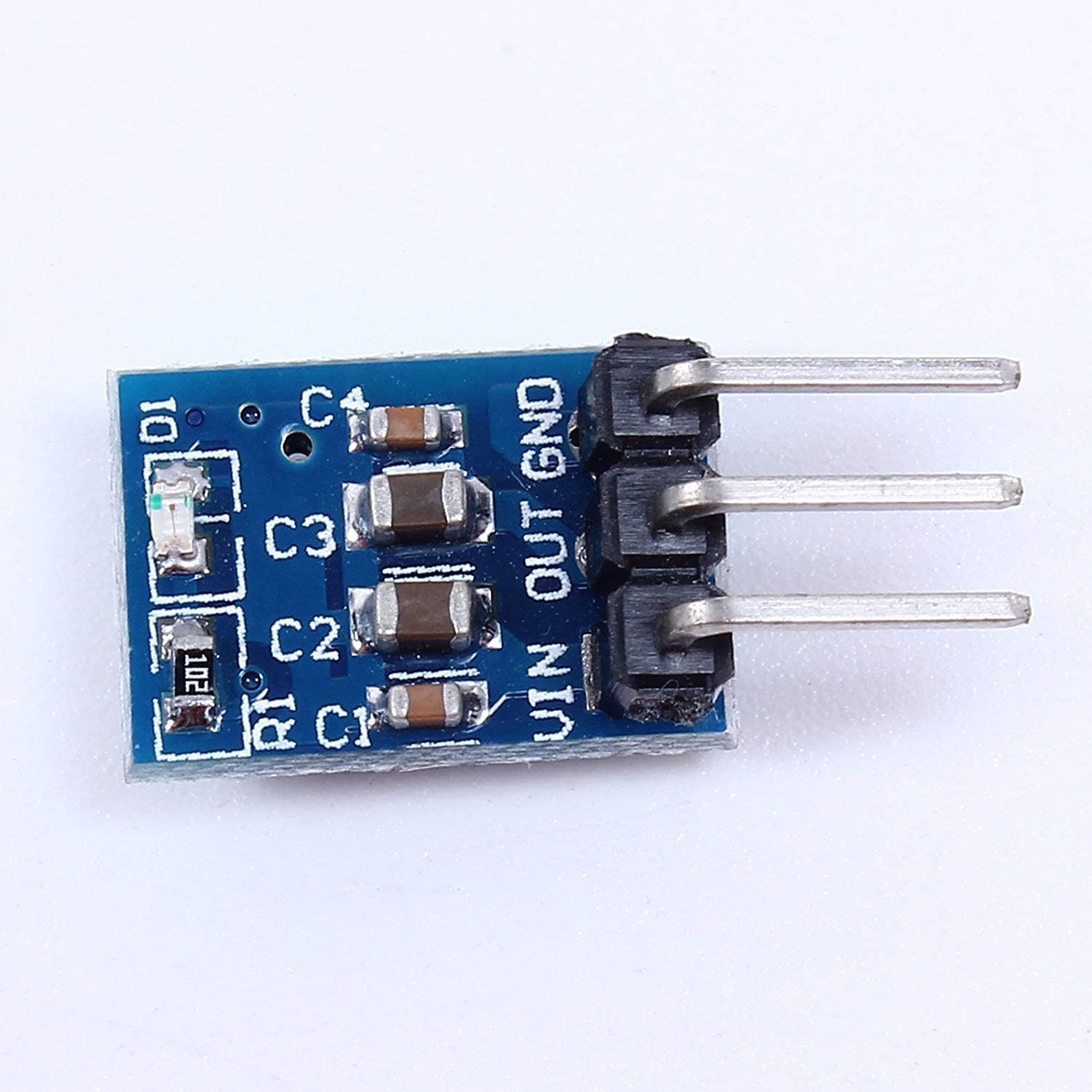

I discovered another interesting Bluetooth LE module suitable for CAT control for ca. 10,- €. I build a simple CI-V interface for my Icoms. The module requires a 3.5 V - 6.0 V power supply, so I added a 5.0 V voltage regulator board for < 1,- € Both modules pull ca. 7 mA. A 9.0 V battery should be able to power the interface for 50 - 150 hours.

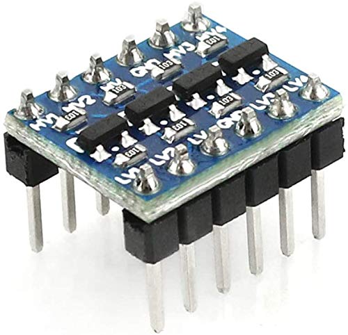

The 3.3 V level fits perfectly to the Icom, for other transceiver brands a level shifter to/from 5.0 V or 12.0 V could be required. There are ready to use boards available.
The interface can be renamed and the baud rate can be changed via AT commands. It is not possible to use this interface for the full TRX control panels, due to the CI-V 19200 baud limitation. I use it mainly for there IC-9700. Pending on my station setup, a USB connection can cause a high noise level on VHF.

Complete CI-V interface
HM-19 module
HM-19 module
Level shifter 3.3 V &lt;&gt; 5.0V
Level shifter 3.3 V <> 5.0V

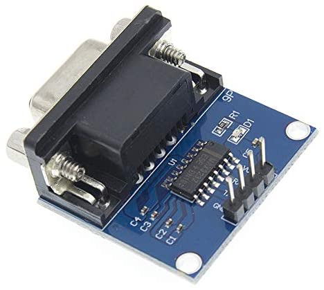

RS-232 level shifter
