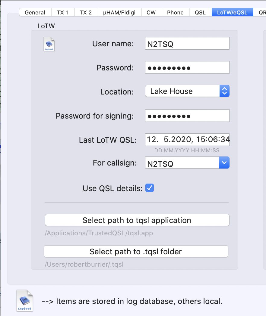

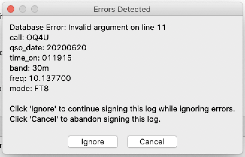

Things had been going great form several years and then about 6 months ago I ran into this issue and have not been able to upload since. I generally export an ADIF with no problems, bit the error arises when I try to confirm the QSOs in the TSQL app. I'll upload a screen shot of the error and my LOTW preferences page. I thank you in advance for any assistance you can provide.
Bob, N2TSQ
Screen shot of my LOTW preferences

Screen shot of the error

Try to set the Location popup to "Ask for".

I confirmed I made the change you requested upon reopening RumlogNG, but still got the same error.

Next step: clear the Password for signing field. TQSL will ask for it. When it works this way, change the password to one without special characters..

I cleared the "Password for signing" field in the RumLogNG Preferences and tried to upload the ADIF file. TSQL did not ask me for the password and gave the same error. There were no special characters in the password as well, only letters and numbers.

Does this happen for each data record?
Does it work when you just use TQSL, without RUMlog?

Thanks for your inputs. The upload from within RumlogNG has started working. I wish I could tell you why, but I don't know or sure. The initial upload identified 527 QSOs which it said were uploaded successfully. However, they never made it into LOTW and all the status flags in Rumlog had been changed to "Sent". This created a puzzle to sort out which ones were among the 527. In the end, I compared my log to LOTW, identified the QSOs and manually changed all 527 flags in Rumlog TO "worked" and uploaded them in smaller batches (~50), all of which were successful. So in the end, I am back to being fully updated and the process seems to work well now.
