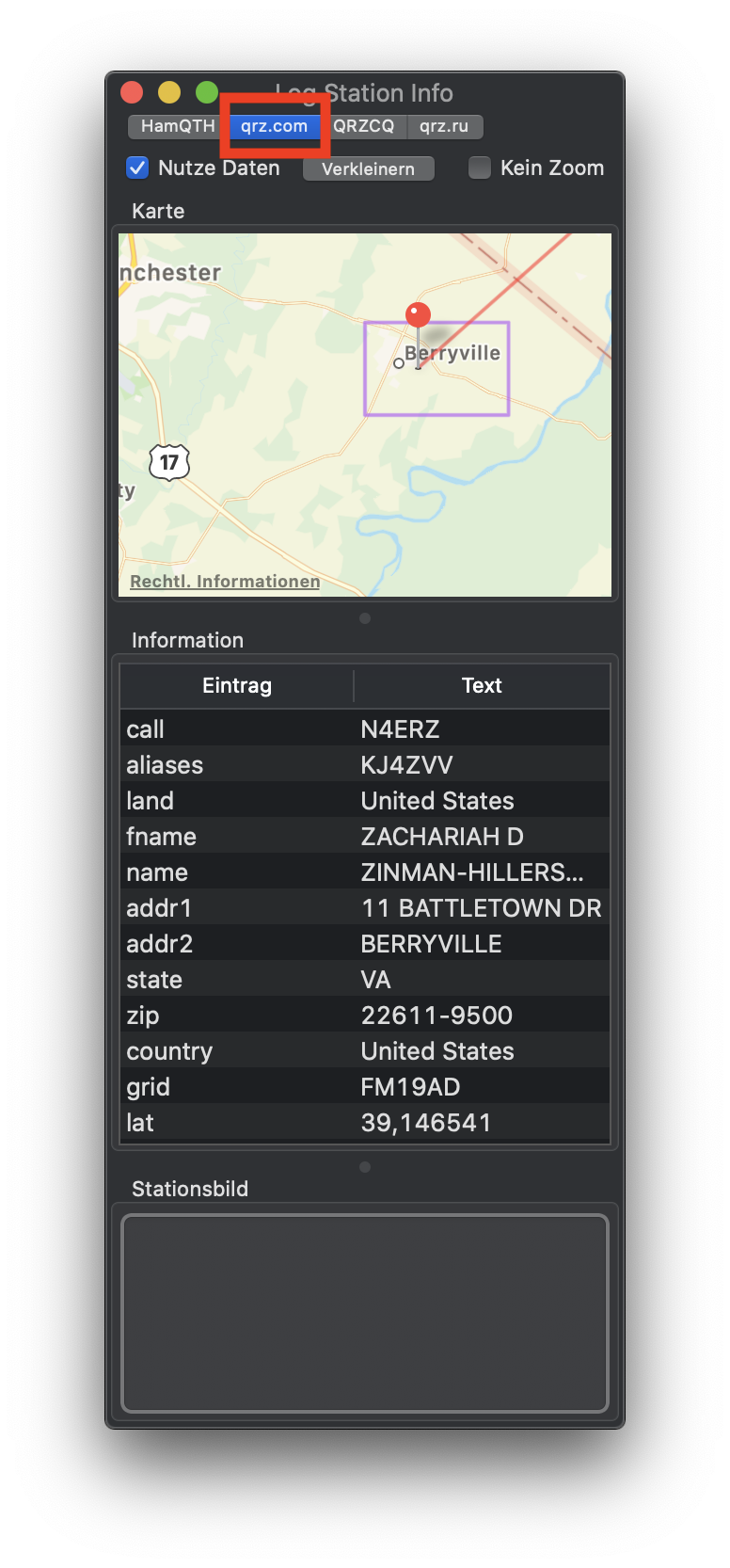

1. I subscribe to the QRZ database and have entered my login information under the preference-database section. When I enter a call in logging and hit tab, I get a pop up that it can't query Ham QTH. I'm not sure how to set QRZ as my default.
Just press the qrq.com tab in the result window

I'm going to tackle these one at a time. I don't see a QRQ.com tab. I must be missing where to look for it. I have the correct info entered int eh QRZ portion of the database section. When I hit tab, nothing populates though.
Here
Here

That worked! Thank you! Is there a way for it to auto-populate or do I need to hit the mall triangle each time (not a problem)?

Keep the window open. Each time you tab out of the callsign field the query starts.
