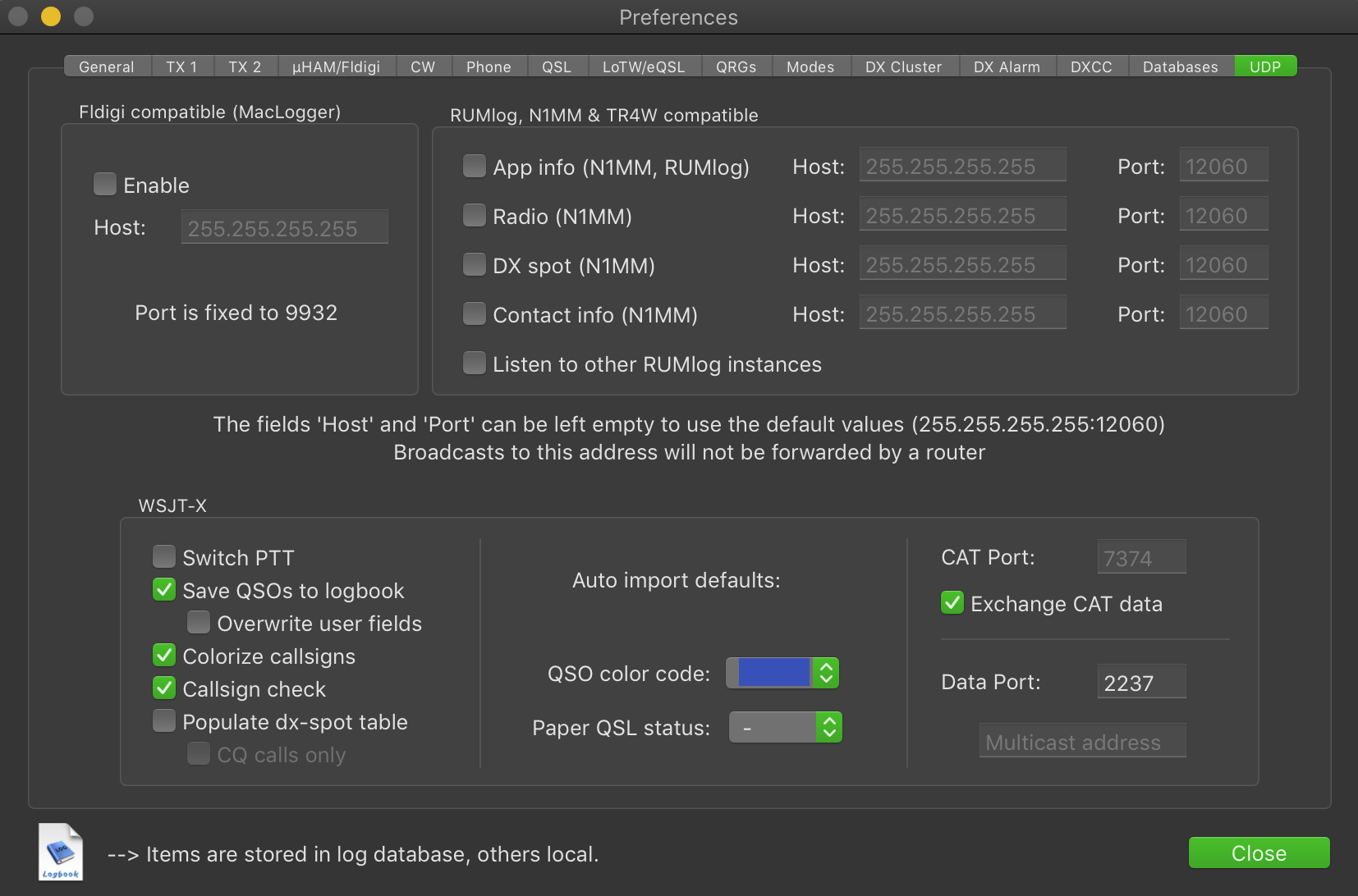

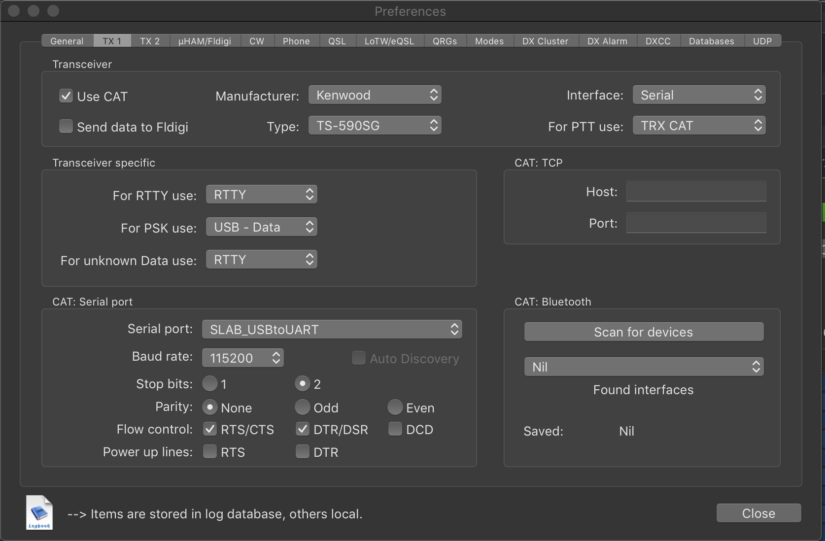

Below images of the RUMLOGNG and WJSTX settings.
RumlogNG
RumlogNG
RumlogNG
