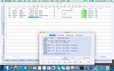

After upgrading to 4.2, I am no longer able to click on a spot frequency in the ALL tab of the DX Spots window for a particular spot in order to QSY to that frequency. However, if I select a tab other than ALL, i.e. 20M, then I am able to click a particular spot frequency to QSY.
Is this an intentional change?
Ron WB2PKR
Definitely not!
But I can't confirm this failure. Anybody else here?
Are you talking about a 'normal' dx-spot coming from the dx-cluster?

Yes, normal DX Cluster in the DX Spots window. I have always used the ALL tab.
For example, in the attached screenshot, I used to be able to double click on 28,028 to QSY for the AM70C spot.
No longer works. I need to go to the 10M tab in this case and double click 28,028 to QSY.
Very strange.
No other changes to MacBook
MacBook used solely for logging and uploading QSOs to club log, LOTW and eQSL.
High Sierra 10.13.4
