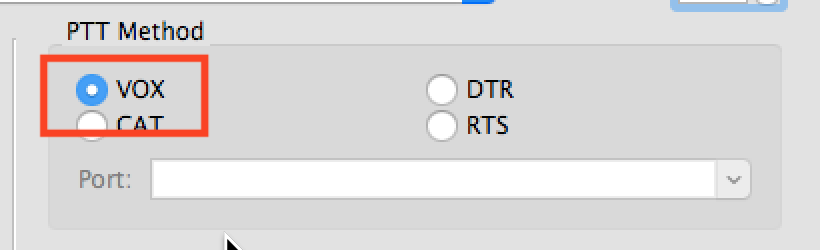

Once again: You have set two options for the PTT. You have to disable one. This is not your problem, but it may have side effects.
I recommend RUMlog for PTT:
Disable PTT in WSJT-X

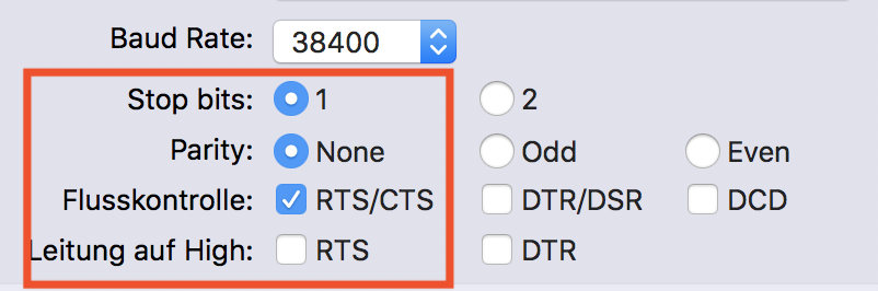

The TS-570 Manual states, the tx uses RTS/CTS flow control. You have set the line always to high, this disables flow control and makes it useless.
Do not power up a line

When I set the PTT Method to VOX, I get nothing transmitted from the Kenwood... no power output is noted at all and with 15 mins of scanning, I received zero responses on FT8. I don't understand that if VOX is selected, how the Mac actually receives audio - because I am not using the physical microphone to get the audio into the Kenwood, surely we want the audio to come from the Mac into the rig...?
Apologies if I am not understanding this, sir.
I have disabled the RTS always high checkbox, and all works the same except the band drop down in WSJT-X has no effect when changed. When I change the band (or frequency via VFO) on the Kenwood, the band indicator and indicated frequency in WSJT-X changes to match that of the Kenwood, but changing it in WSJT-X has no effect on the kenwood at all.
