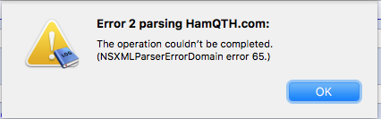

I installed the newest version, and am getting HamQTH parsing errors - screenshot attached
Re: RUMlogNG version 3.7
Seems to be a server side error, see here: https://www.hamqth.com
Internal Server Error
The server encountered an internal error or misconfiguration and was unable to complete your request.
Please contact the server administrator at petr@ok2cqr.com to inform them of the time this error occurred, and the actions you performed just before this error.
More information about this error may be available in the server error log.
Apache/2.4.16 (Ubuntu) Server at http://www.hamqth.com Port 443
Don't blame RUMlog. ;-)
I am seeing a parsing error box now related to qrz.com - the QRZ site seems to be working, but maybe not the raw data feed RumLog uses?
I experienced just the same. Seems to be an minor inconvenience (or bug :-( ) in RUMlog.
When you query hamqth.com and you toggle to qrz.com before the query times out, the following Hamqth.com error states qrz.com error.
Just disregard.
