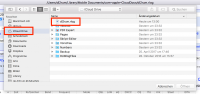

Re: The file couldn't be opened (Logbbok)
When I save my log file in the iClouds root, it looks like this:
From the Opern Logbook dialog. you can just navigate to the iCloud:
It seems, my backup includes the iCloud.
