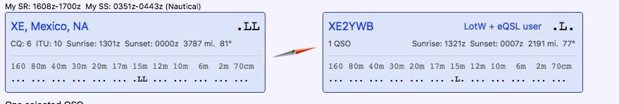

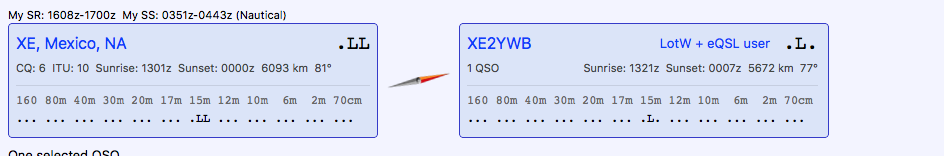

Here are screen shots of one station's info. Notice that the distance in miles to the station is much lower than than the distance to the generic country. The distances in km are very close, as they should be.

Tnx for the observation Bob. Due to programmers fault, the conversion from the metric to the english units is done twice.
The Station Info Box and the Calculations window are affected.
It will be corrected in the next version.
