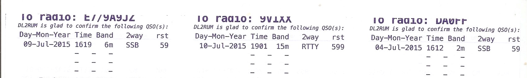

I'v got my printer to print borderless somehow. Instead of defining custom paper size, I've used Borderless A4 from the list of sizes for this particular printer. The outcome still does not look as it should. The printer did start printing from the very edge of the paper sheet, however letters are cut off. Please check the attached scan. I don't think it's a printer issue. What printer do you use ?
Avery 3747 scan, borderless printing
de SQ2KLU
Daniel
Posts: 3099
Re: Avery 3474 labels cut off on the top
Hi Daniel,
in your scan I can't see if the missing upper parts are
  • out of the label
  • out of the paper
  • just not printed
My printer isn't able to print borderless, so I use 3475 (70x36mm). My sheets have a 4mm gap at the upper and lower edge, this is perfect for my printer.

On the scan, the missing part is out of paper.
However if I do standard printing with paper size with margins set to 0, the missing part is not printed. There's about 3mm gap between edge of paper and start point of the printout. It looks like this part is not printed. It is almost like the margin was somehow hardcoded in the file (PDF) or RUMlog as this part gets never printed. My trick to print it is to set up 2mm margin on the top using custom paper size. However that creates second empty page.
If the entire printout was 2mm lower, it would have been perfect. At least on the top. Bottom should be fine too.
Is anyone using 3474 ? Or am I the first one to test it ?
