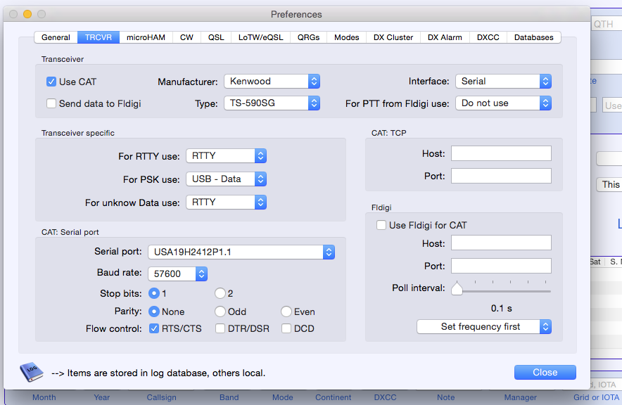

Can you post a screen shot of your TRX settings please?

I've attached a screen shot of the transceiver set up.
John N1JM
Posts: 3104
Re: TS-590SG Frequency Readout
My error, try the latest version please: http://dl2rum.de/RUMlogNG/RUMlogNG.zip
For an unknown reason, I removed some code after successful testing.

Excellent. Works great now.
Thanks and 73, John N1JM
