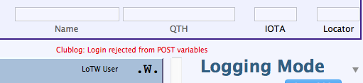

Greetings,
I am new to RUMlog. I recently signed up for Clublog and cannot "Upload all QSOs to Clublog" With each try I receive the following message:
"Clublog: Login rejected from POST variables"
http://dl2rum.de/forum/download/file.ph ... iew&id=341
Any guidance is appreciated.
Ric KE7NUQ
Posts: 3108
Re: Clublog: Login rejected from POST variables
This error means, Clublog can't accept your password or user name.
Do you have any special characters in the password? Then try another.
