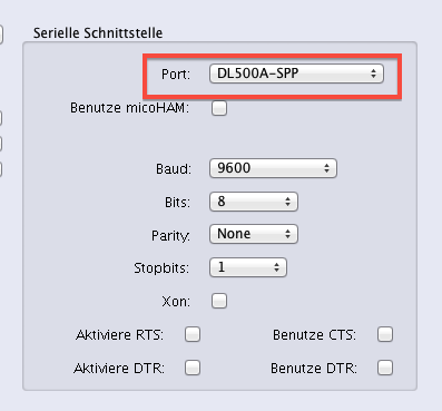

Re: Newby & Need Help with TS-590
Check if you have selected the COM port which is connected to your transceiver. When you have installed the interface driver, the name should be listed in the popup menu.
The port you see in my screen shot is not for TS-590, it's for another device.
When you use a USB-Serial converter cable, you will need the applicable driver for that interface.
When you use the direct USB connection, you will need the driver for the chip inside the TS-590, most probably a Silicon Labs chip. But I'm not sure about this.
