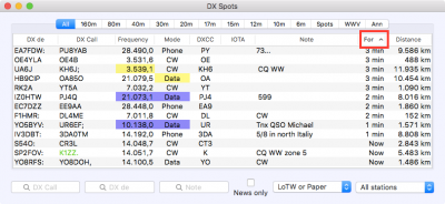

In the Menu / Window / DX Spots happens something similar. The table fills up day date/time of "arrival" of the spot. But if the table is sorted by another column (clicking on the header), then this table is always sorted by the once clicked header. I have not found out how to resort it again by date / time.
Click the "For" header:
