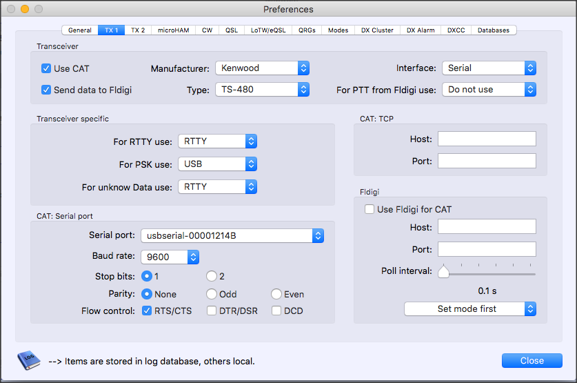

Please post a screen shot of your TRX settings.

Her we are! :) tried different settings...only after restart ...reset cat helps!
cat sett
cat sett
Re: ts-480SAt and cat
When you reset the CAT via menu it works after that?
