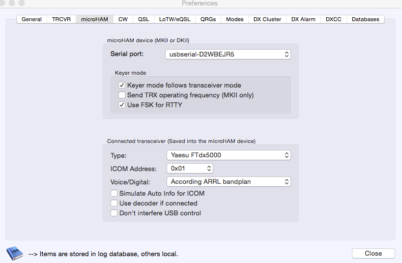

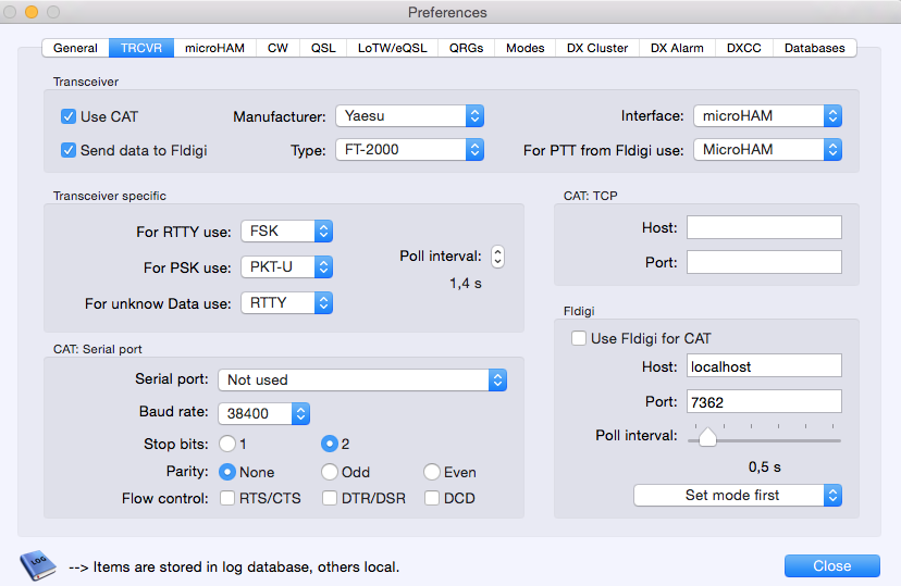

The CAT support of FTdX5000 works with those settings (with the exception of cw memory read/save)
