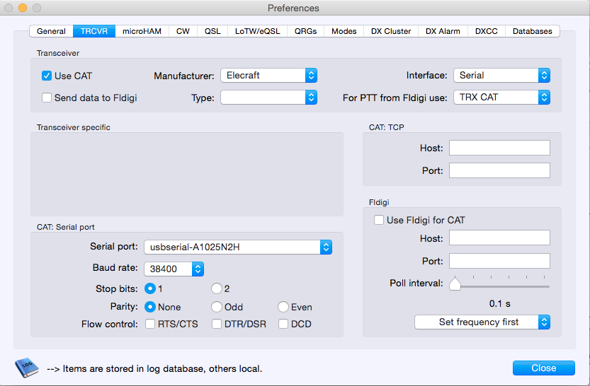

I can't get CAT working. The settings are the same as I used in classic RUMLog (38400,1,N) which still works fine. I have tried re-starting NG and cycling the rig and Menu>Transceiver>Reset CAT.
I have a K3, P3 and SteppIR antenna. I have not tried fldigi yet.

Can you post a screen shot of your settings please?

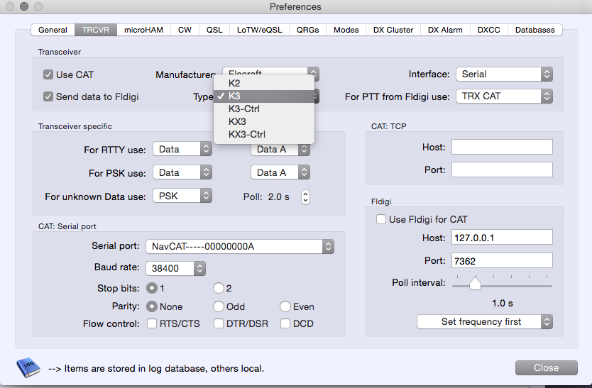

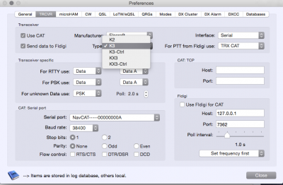

CAT settings/K3
CAT settings/K3
DL2RUM wrote:Can you post a screen shot of your settings please?
73, Mike NF4L
Posts: 2994
Re: K3 CAT
You have to select your Elecraft model from the 'Type' popup menu. Use the '-Ctrl' selection for a full control window.

DL2RUM wrote:You have to select your Elecraft model from the 'Type' popup menu. Use the '-Ctrl' selection for a full control window.
The popup says "Item 1" "Item 2" "Item 3"
After selecting an "Item", the closing and reopening preferences, the popup is correctly populated.
