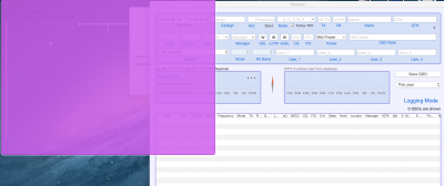

When I try to import adif to NG I get a purple screen exception as attached.
Yosemite 10.10.2
Dana VE3DS
This is purple screen
Screen Shot 2015-02-19 at 8.24.16 PM.png (31.15 KiB) Viewed 10247 times
this is comment from right click on right side...

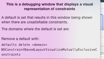

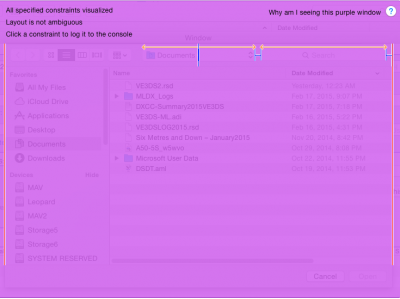

Re: Purple Screen - Exception
Very interesting. I have an idea what happened, but I don't know why. It seems you are the only one with this problem. It seems to me, the window in question is a standard OS-X open file requester. You was not able to select a file before the crash happened, right?
Please try the following:
  • Start RUMlogNG
  • Open the Terminal and enter as mentioned in the printout:
     defaults delete de.dl2rum.RUMlogNG NSConstraintBasedLayoutVisualizeMutuallyExclusiveConstraints
  • Go to the ADIF import
This flag will be set each time RUMlogNG starts. When this workaround works for you, I will remove this flag from the code. It is a trouble shooting aid for windows wit an incorrect layout. In this case, I have no control, since it is an OS-X window.

I was able to select the .adif file to import, but then it appears to fail, as no file is imported ....

Tom, ran script, now purple screen gone.
