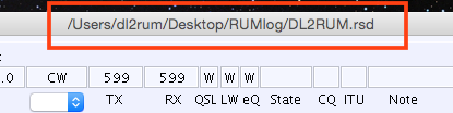

There should be no markable delays up to 100.000 QSOs. Never tested with more. So there must be a problem. The file name is the name, you have selected when you created your logbook before you was able to import data. You can find the path in the title bar of the Main Logging Window.
