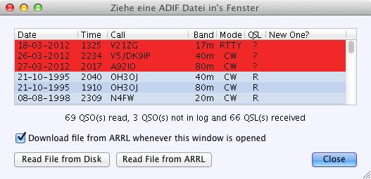

When reading the LoTW data, RUMlog shows clearly how many QSO recodes were read and how many weren't recognized.
You should be able to find out if the missing QSOs are (1.) not downloaded or (2.) not found in your log (shown in red).

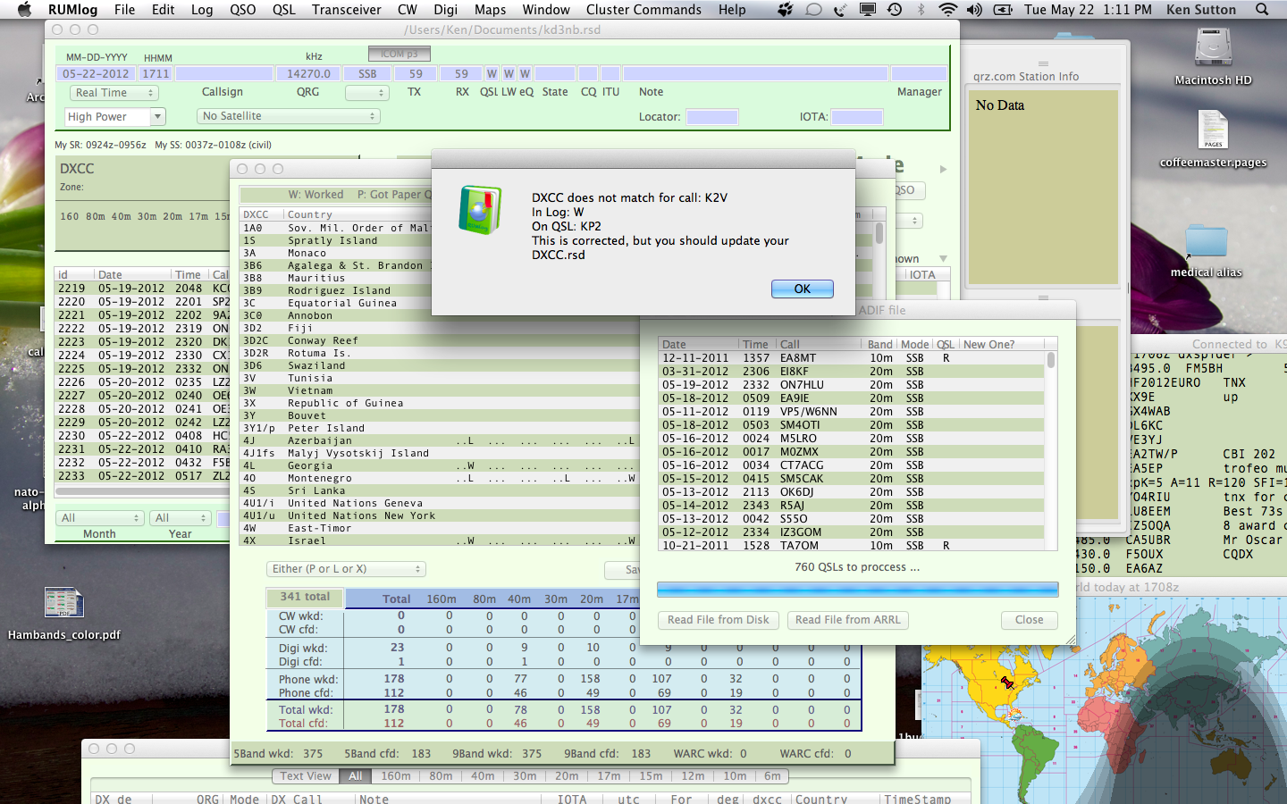

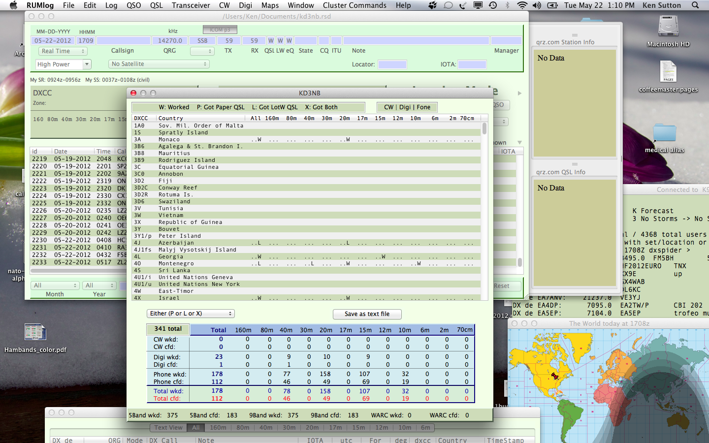

This is what it looks like before I did a reload from LOTW
During the reload I get this error

after the reload it looks like this - note one less confirmed.
but LOTW still says 116
Maybe I am misunderstanding something in how this all works but I would think the LOTW count and RUMlog counts would match. Initially it was off by more than 3. I went in and edited by hand to get this close.

The problem with K2V could point you in the correct direction. Do have got more messages like this? Follow the tip and enter the irregular call sign K2V into your dxcc.rsd database under the calls tab using the application 'EditDXCC'. See the documentations. When you have made the changes restart RUMlog and select Menu-->File-->Recount DXCCs

The K2V problem seemed to be self healing and never occurs again. It was the only error message.

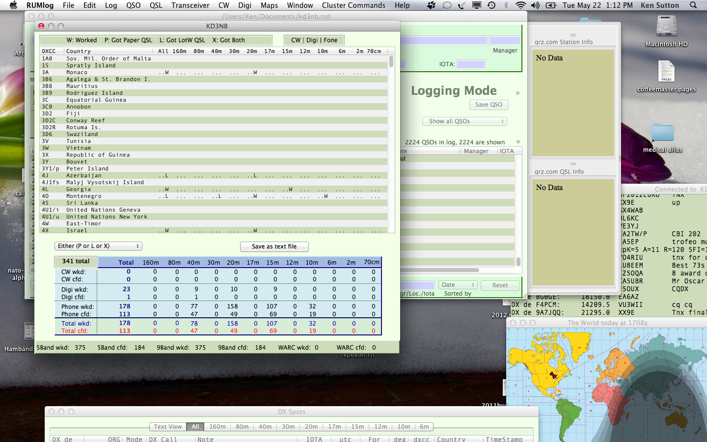

I forced the recount and the DXCC count is now 112.
