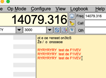

Thank you Tom I now have RL controlling FLDIGI from TX can chose mode QRG etc and FLDIGI follows
RTTY appears and tested OK great but still missing something on CW ? for CW do not wish to use the winkeyer but the rig ? some set up required in FLDIGi
