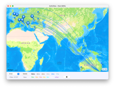

Rumlogng is excellent and I greatly appreciate your work. One question, selecting "window->activity log->my qsos" brings up a nice map showing pins and paths from contacts in the log, however at its max zoom, it still shows only about half the planet. Is this the best it can do? Is it an Apple Maps limitation? See the attached screenshot.
Thanks!
Carl,
vk1kcm.

It's by design, see Apples Map application. It's the same 'problem'.
You could select another map type to see the globe.
