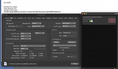

You can see everything in the attached image
Thank you

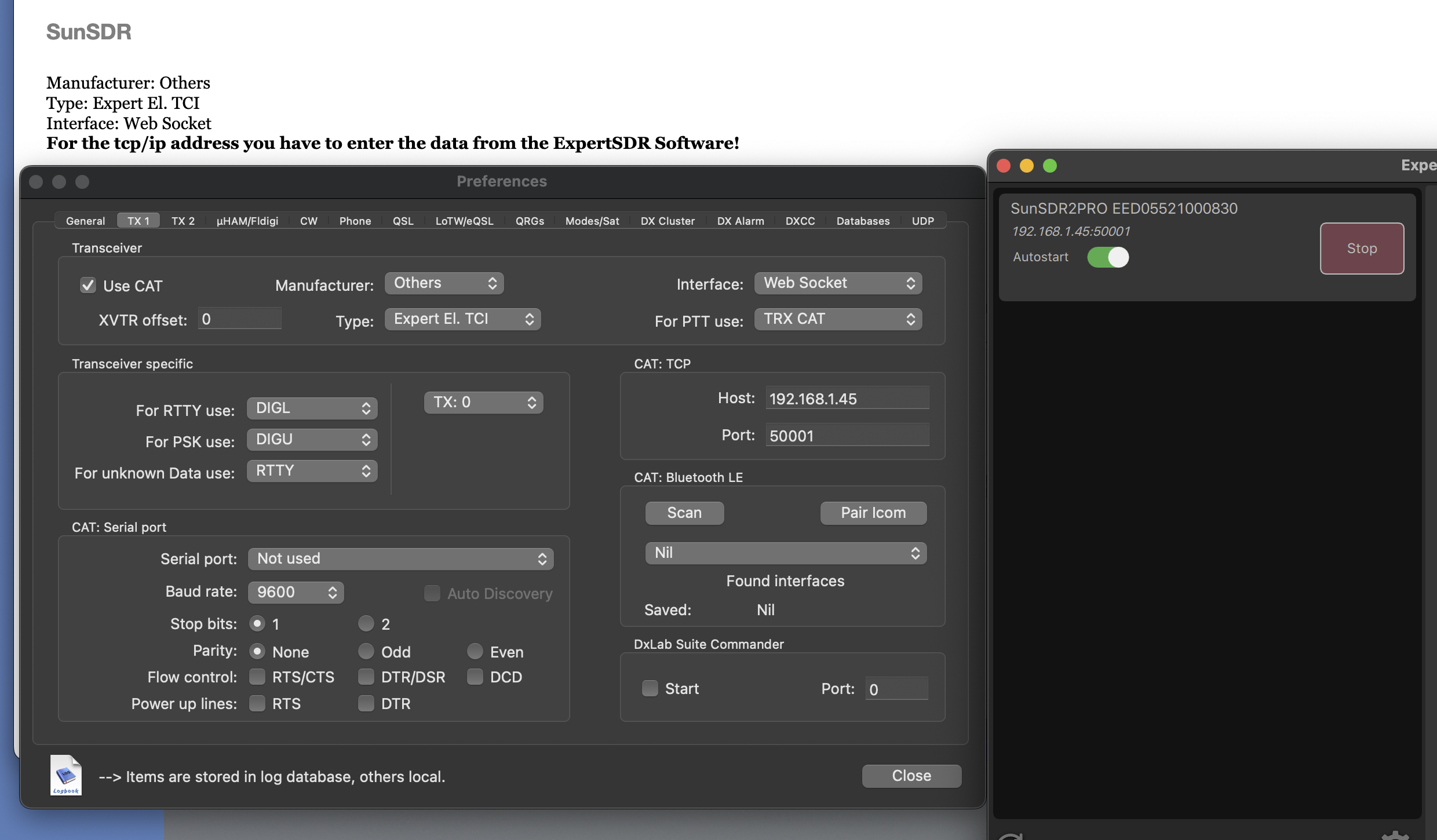

I hope the attached image is ok
Thank you
73 Roberto IU2NUB
Re: Dx spot don't change frequency on SUNSDR2
Quick test:
  • The Mode and Frequency labels in the logging mask must be written in green text color.
  • Turn the VFO knob - the frequency read out in RL should follow.
  • Enter 7007 in the Callsign entry field and press Enter - the trx should qsy to 7007 kHz and switch to CW
Check your web socket address and port settings, It seems to be wrong.

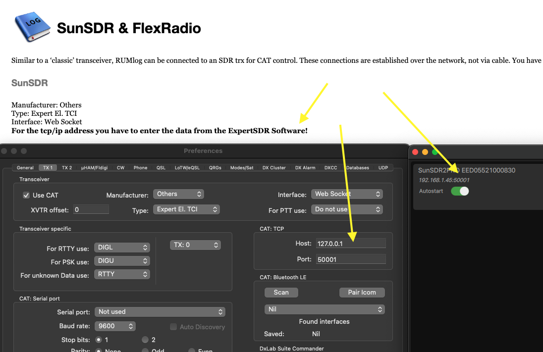

I found the problem
But I think there is an imperfection in the manual (but I may have misunderstood the manual)
To get everything ok I had to enter the IP of the Mac in the Cat:TCP field, not the Eexpertsdr ip.
73 Roberto IU2NUB
