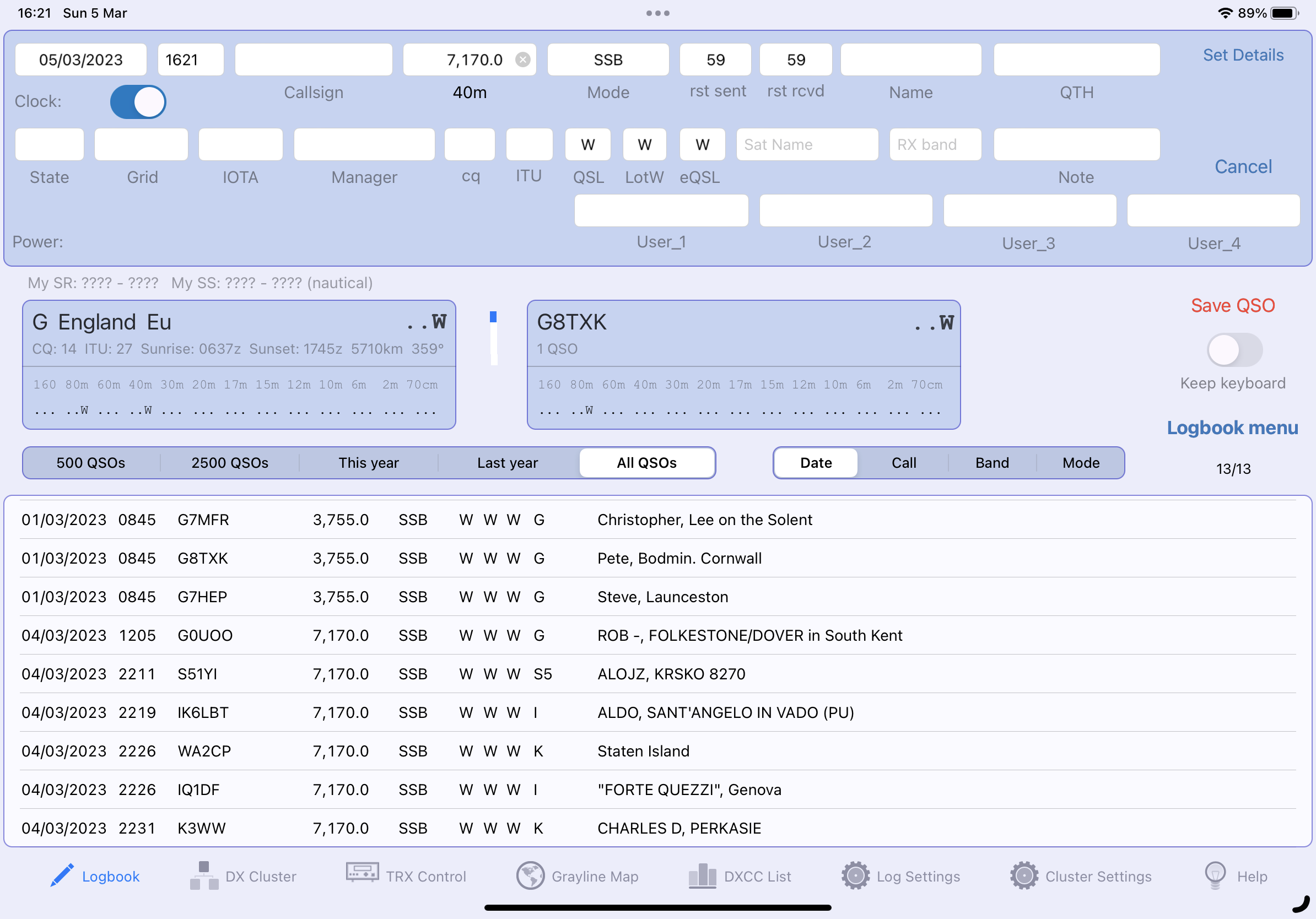

One of the things I don’t understand is the box just above the log section, which appears to show the location of the DX station country and it’s bearing and distance however these are totally wrong. I have entered my details including my locator. Above this are “my SS and my SR” what are these?

SR and SS are your sun set and sun rise times.
You should provide a screen shot of your wrong seen data.

Here is a screen shot :
As you can see the distance is completely wrong and no SS or SR. I’m probably doing something wrong!

Do you have set your grid square?

Sorry about the delay been off Aire for several days! I checked on the Log Settings page and my Callsign and locator were missing, I am sure that I entered them! Do you have to enter them each time you open the app or should they remain ready for next time?
