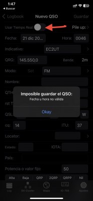

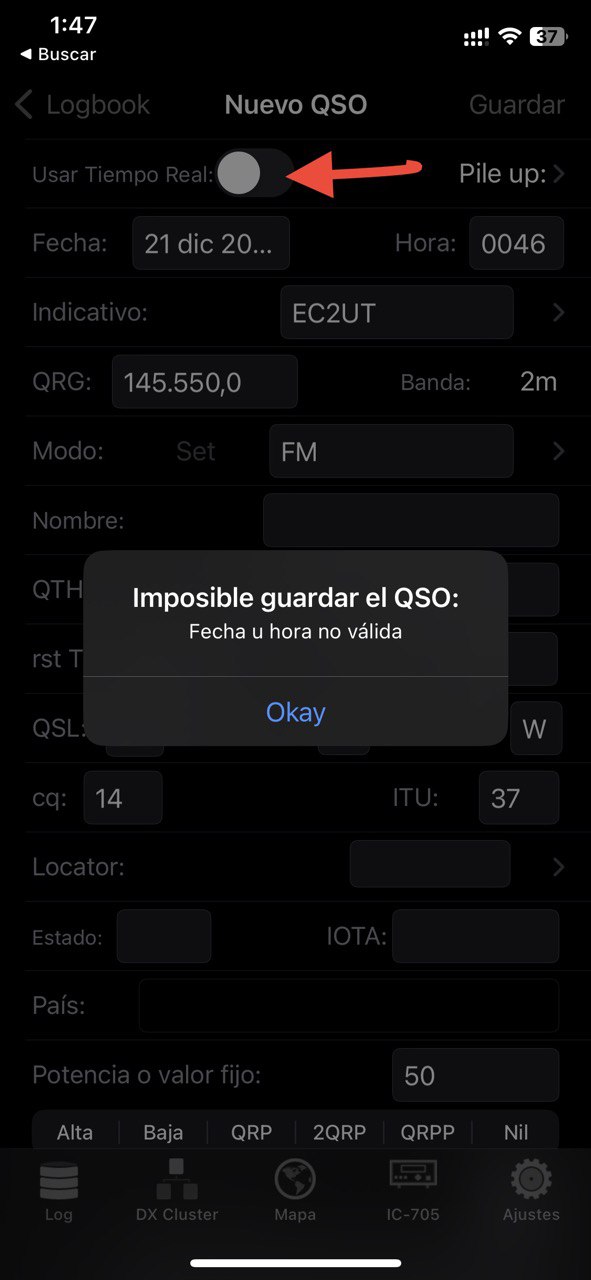

I have observed in the App for iPhone and iPad that if you enter the date manually it gives an error and does not allow the QSO to be recorded.
With the option activated to use in real time, it does allow you to save the qso correctly.

If "Real Time" is off , it is not possible to save the QSO.

"Impossible to save the QSO"
Invalid date and time

Tnx, I was able to reproduce this. I have to fix the problem.
