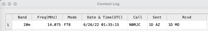

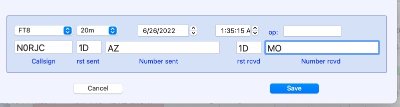

The exchange for the ARRL Field day is a combination of the station class and ARRL section. In my case, it is "1D AZ". I noticed when using WSJT-X and RumlogNG that the station class is coded in the signal report field and the section is entered in the exchange field. I expected both parameters to appear together in the Exchange (number received) field. Here are a few screen shots illustrating what happens. I'm not sure if this is working as intended, or a bug, but thought I would check. I am using RL version 5.9 and WSJT-X version 2.4.0
Here's the WSJT-X Contest log entry.
Here's the RumlogNG contest record for the same QSO:
