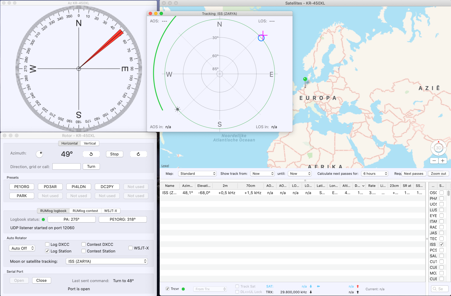

Hello Thomas,
I'm having the Trcvr working too but I see still the frequency from the Icom (28MHz) instead of the transverter frequency (145MHz). Which is normal I believe without an additional setting like that is present in RUMlogNG for the transverter offset. Is it possible to use the transverter frequency and/or additional settings for transverter offset? Please see the attached image. All bubbles are green and at the Satellites screen the frequency is displaying 28MHz.... but the doppler shift is not send to the Icom and I think that is because of the wrong frequency (10 meters instead of 2 meters)?

I have to admit I didn’t use rotor for a long time. Used Gpredict for ISS tracking and CAT.
Today I tried Rotor again (could not get Gpredict to run) and WoW Rotor uses the transverter offset! I completely missed that update!! After changing some settings all was working correct and great. CAT and Rotator. What a great all in one application is RUMlogNG! Now waiting for the SSTV images from the ISS :D
