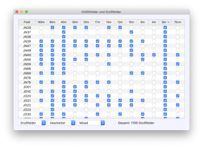

This is the only screen I have seen so far.......The screenshot you posted looks promising. Will try to reach that stage....

Hold the mouse over a box to see the number per band.
How many QSOs do you have in your logbook? Here it takes 10 seconds only for 21.000 QSOs and 1100 different grids

Just an update. It took 11 minutes to reach the screen like yours with 41k QSOs and 1746 Squares.
Trying to narrow down only lotw confirmed grids, it took another 11 minutes with 1518 Squares.
I am using a Late 2014 mac mini with Dual core i5 2.6Ghz/ 8 GB Ram and SSD.
It may help if there is an option to see only HF or only VHF grids, or an option to elect bands.
