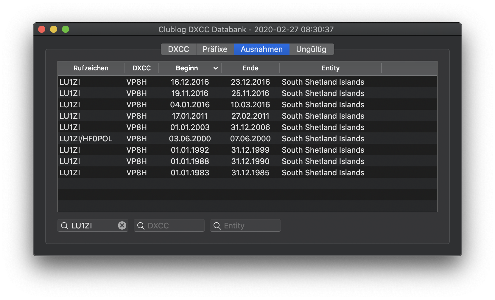

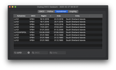

Club Log call tester shows the following for 2017:
Interesting. These data are not consistent with the data Club Log provides in the xml dxcc database.
You can:
