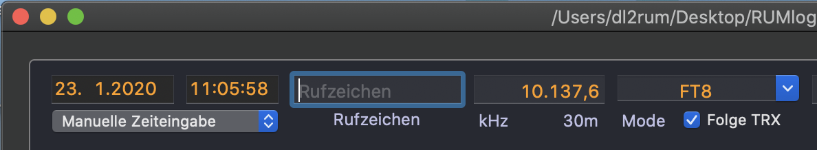

If there's already an easy way to do this without a trip to the preferences, I must have missed it!
You can (mis)use the Real Time popup menu. When you select "Manually time entry", the mode and frequency fields will not be updated by CAT.
Manual time entry disables the real time clock and CAT data take over
