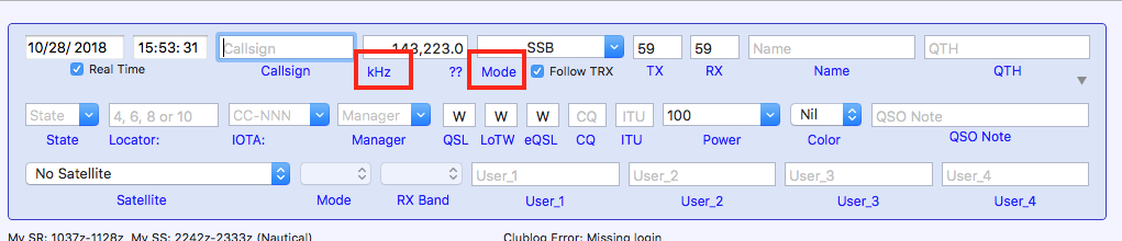

See to the logging fields in the logging window. In which colours are kHz and Mode written?

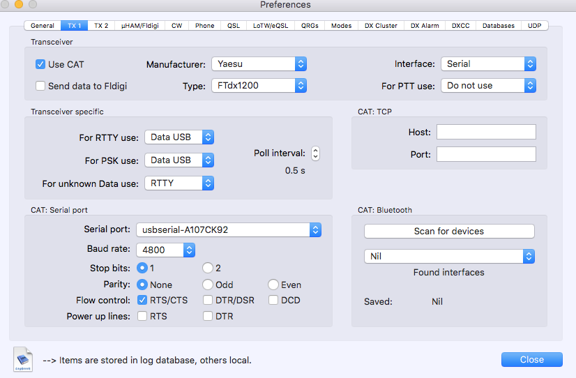

Show us your TRX settings.

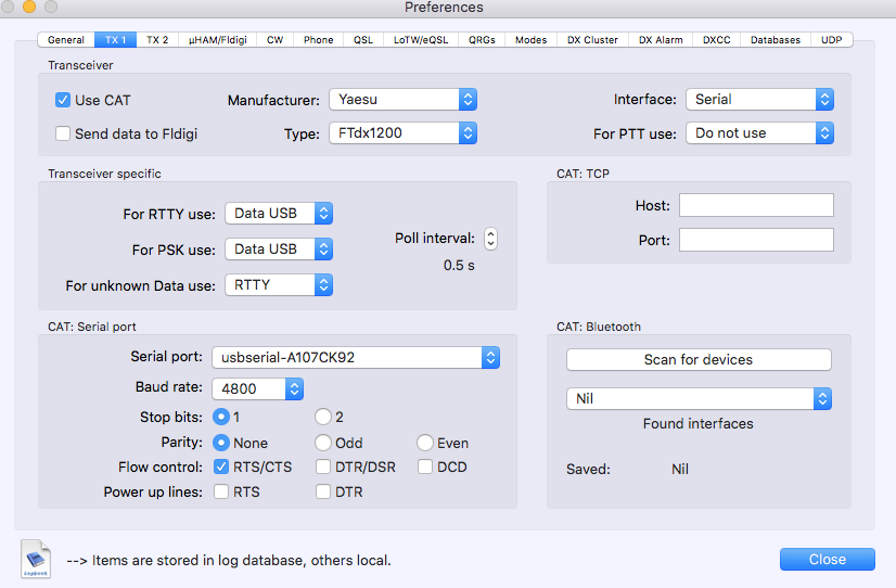

This looks good, when your try is configured for 4800 baud and RTS/CTS.

http://dl2rum.de/forum/download/file.ph ... 3f78514110

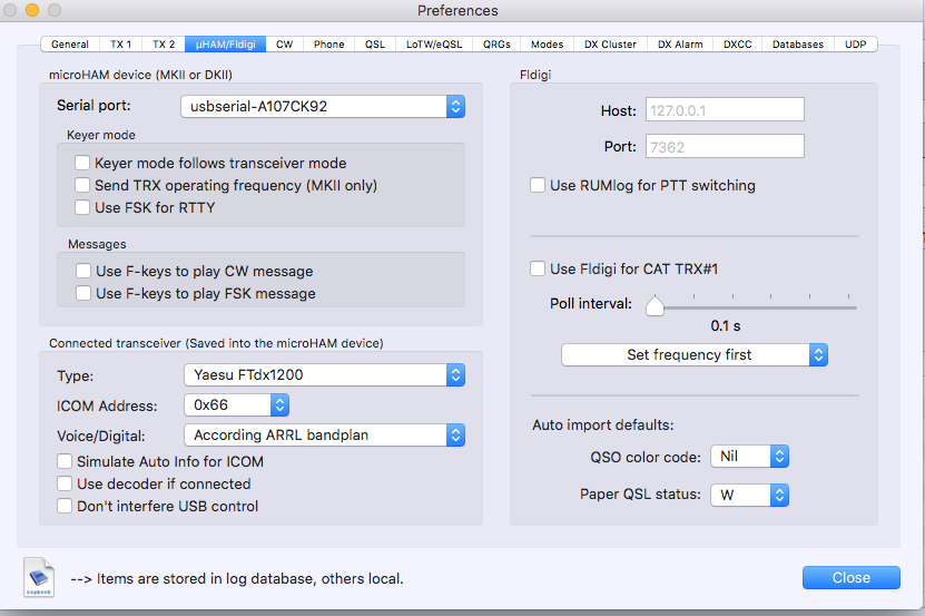

Do you use a microKEYER II or DigiKEYER II? The port name doesn't look familiar.

DL2RUM wrote:Do you use a microKEYER II or DigiKEYER II? The port name doesn't look familiar.
I have NO idea what those are.... :shock:
That was the only Serial Port option on the Port drop down screen.
Re: RUMlogNG for Yaesu FT DX 1200?
Then reset your selection to Do not use! Only the settings under the TRX tab are required.

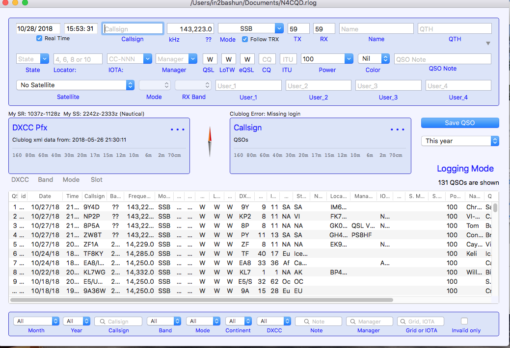

DL2RUM wrote:Then reset your selection to Do not use! Only the settings under the TRX tab are required.
Changed to "Not Used", still no communication between my Transceiver and RUMlogNG. :roll:
Check again the text colour for the kHz and Mode label. In your last screen shot it is shown in blue, it should be red or green when you have configured CAT.
