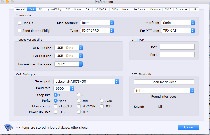

Can you provide a screen shot of the trx setting pane please?
DL2RUM wrote:Can you provide a screen shot of the trx setting pane please?

Re: RUMlogNG not talking to transceiver....
Unread post by DougY »

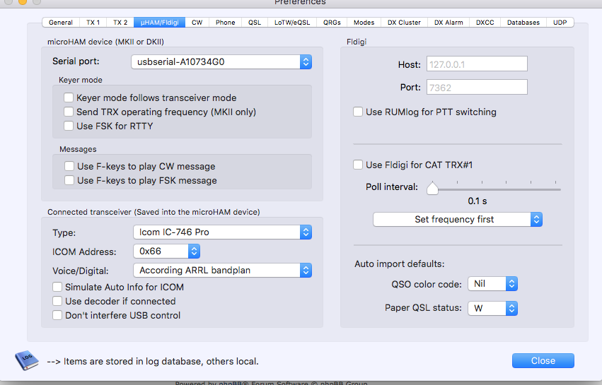

DougY
Posts: 39
Joined: Wed 23. May 2018, 17:19
You have to enable the option “Use CAT”.
Why do you have selected a serial port in the microHAM settings? Do you use a MKII or DKII?
DL2RUM wrote:You have to enable the option “Use CAT”.
OK, I put a checkmark on Use CAT, and I removed the serial port in the microHAM settings. Will see how it works now.
