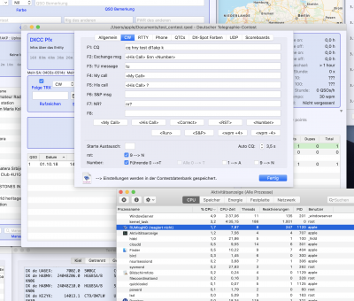

eben geladen und getestet. Fehler ist immer noch da.
Der Ball erscheint und das Programm friert ein, wenn ich in den Eigenschaften oder Contesteigenschaften irgendwohin klicke.
Siehe hier:
73 de Andy, DL1AKP

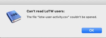

I found a bug with V 4.0.2 and Mojave. When I select "Load LOTW users" under the "Online" menu item, Rumlog reports a message in the attached screen capture. (I have Rumlog installed in ~/Applications, and not in /Applications)
Posts: 3099
Re: RUMlogNG version 4.0
Seems not to be a bug. Looks to me like a server side error.
nu7b
Joined: Sat 15. May 2010, 23:47
Unread post by nu7b »
Yes I can confirm this. It is not a bug in RumlogNG. Thanks for the hint that i could follow up on. I was getting traffic from the dx cluster, but a proxy had apparently interfered with the LOTW user query.
