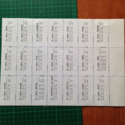

Happens to me something.
Do not use the AVERY 3474, but a generic of 70x37 (24 labels per A4) 5staroffice brand, model 903814. No top margin or lateral margins.
The printout is shifted down and to the right.
Not printing the last three labels.
To see how to print, I have attached a picture of the page, with pen marking the separation of the labels.
My printer is a Brother HL-2035
As could be solved?
Regards.
Manuel EA7TB

¡Hola Manuel!
This is because you have not set up the correct paper size before printing.
  1. RUMlog Menu-->Edit-->Page Setup-->Manage Custom Sizes...
  2. Click + sign and call your paper size somehow "RUMlog" or something else
  3. Set paper size to: width 210mm, height: 297mm
  4. Set all margins to: 0mm
  5. Click OK
  6. in Paper size field, choose your newly created paper size
  7. Quit RUMlogNG and run it again.
  8. Try to print now
Let me know what is the outcome. If you will have problem with 3 first labels cut off from the top, I'll tell you how to bypass that.
