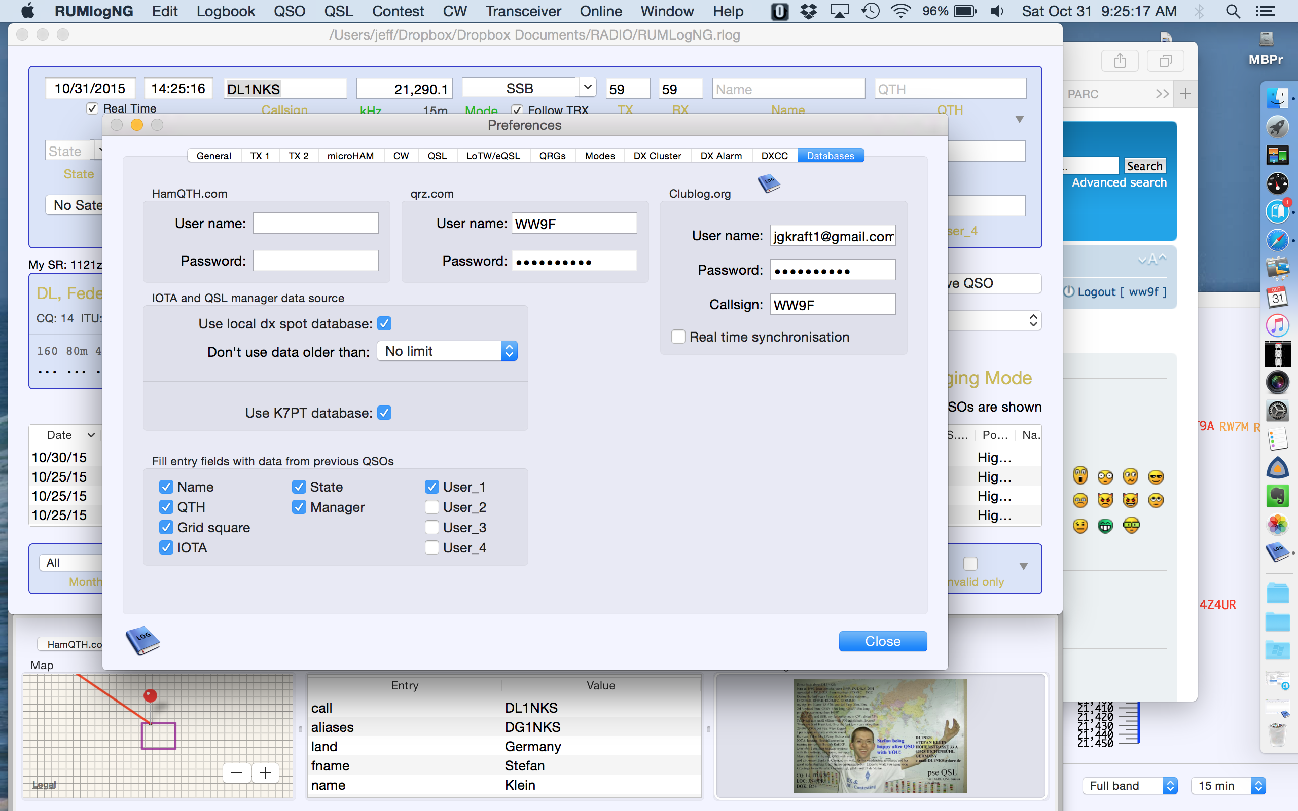

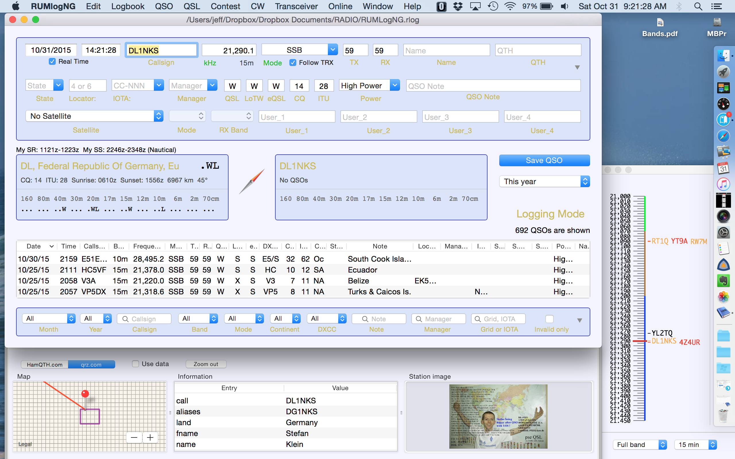

The test app does correct the CAT control problem--that is great. However, I still do not have the DX station information filling in the log--only displaying in the Information box from QRZ. I have attached screenshots to show the logging screen and the DXCC preferences.

Jeff, you have to check the box "Use data"

Thank you! I had originally selected "use data", but in the course of trying different settings, it became deselected and I failed to check that setting. Thank you again for all of your support.
