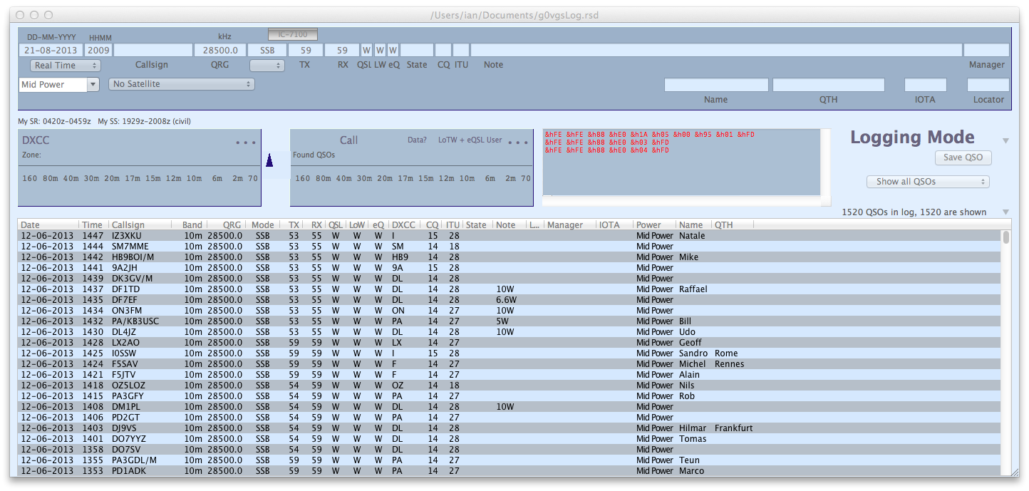

That does not seem to work at all Tom. Screenshot included..

Posts: 3114
Re: Ic-7100
This was not expected. But now we are sure, that the initialization sequence is correct.
