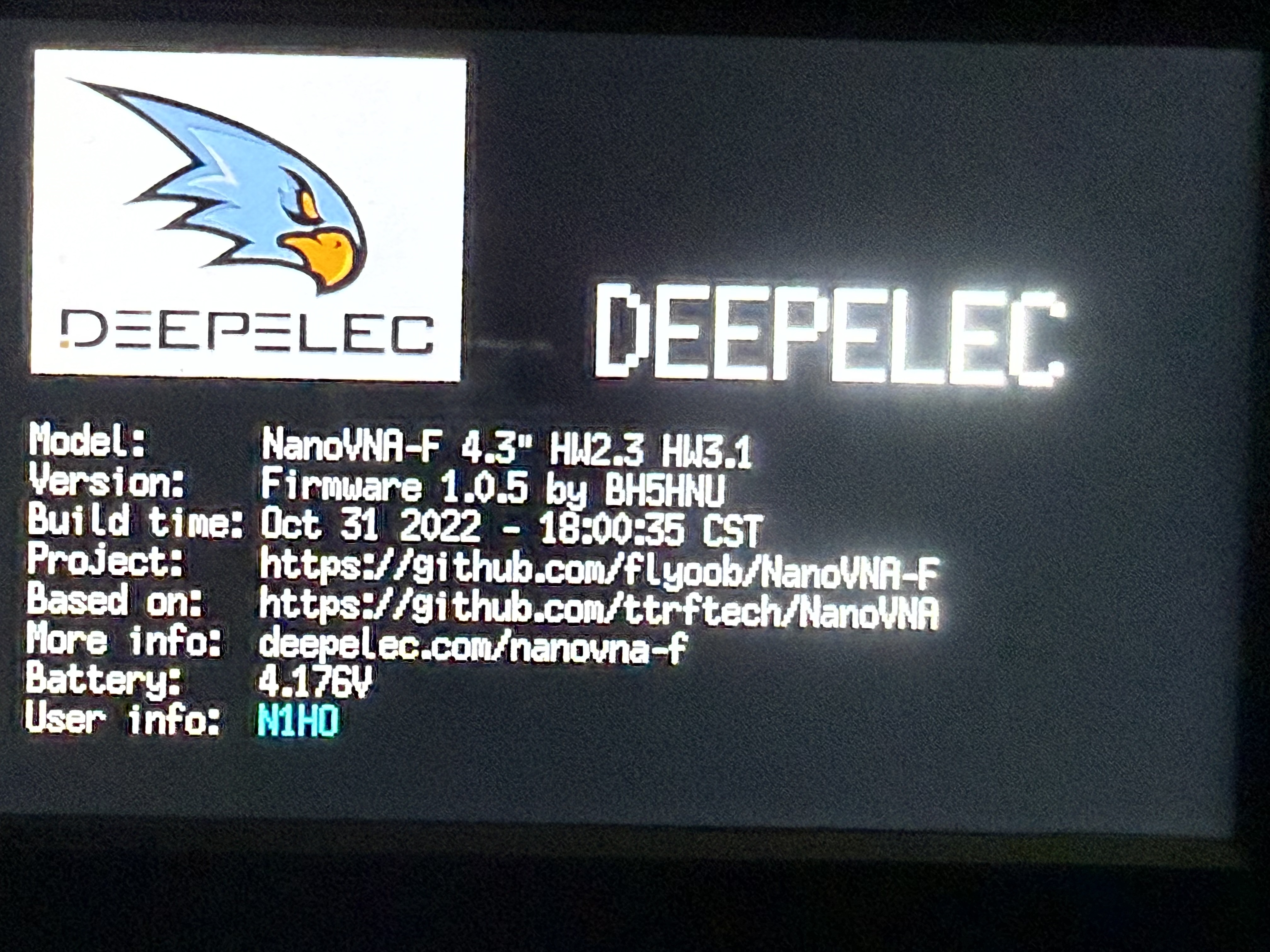

Can you post a screen shot of the Welcome / About / Info screen of your device?
Do you have tried both NanoVNA settings?

"Both" NanoVNA settings? Sorry, didn't know there were 2; can you clarify? Maybe that's what my problem is :-)
Hopefully, this screen shot will help:
